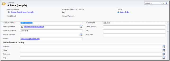

I will also add lookup fields to these in a new section on the Account record.
The results are something like this.
The Country record:
The State record:
The Postcode record:
The City record:
and finally the lookups on the Account record:
