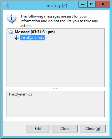

Unfortunately, his remark in bold not to forget to Refresh elements after adding a new attribute value for a new descendant class did not help: my test class still instantiated my base TmxDynamics class!

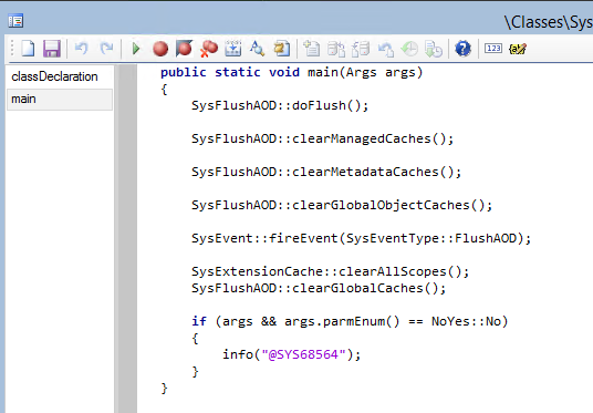

After debugging I found that the Refresh elements does not actually flush StaticMaps for values in GlobalCache.

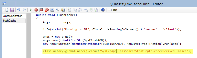

Neither does SysExtensionCache::clearAllScopes() nor SysFlushAOD::clearGlobalCaches() actually flush the "SysExtAppClassSearchStratDepth.checkDerivedClasses", which is responsible for finding all inherited classes.
I do not know if this is a Microsoft bug, but if you cannot manage to get your newly added class, try to flush this value from the global cache.
I got what I want.
