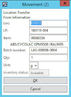

First of, there is the option of simulating the web based client by opening the Form WHSWorkExecute:
when opening it you get a X++ form that is ideal for debugging the code - the menu is customizable - so your may look different

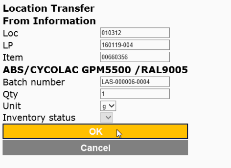

And now to the problem, when ever we did a Location transfer (that was setup as a movement as per the guides in the Microsoft blogs above - so it's not the standard naming) in the mobile device application it went back to the From page.

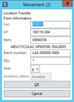

We could copy the license plate into the client and the rest of the data would be filled in - seemingly:
Once we pressed the OK button however, the client would skip back to the From-page again, deleting the Qty:
Since the environment is without customisations, we suspected that the issue was data related - furthermore we could tell that the Inventory status was apparently blank even though we confirmed the status to be available in the On-hand inventory.
We could do transfers in the AX client via the Transfer journals, so the data related to the item was correct.
