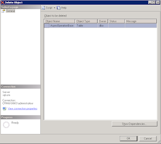

The table that we want to delete the table is AsyncOperationBase. First thing to do, identify all the dependencies for that table. To do this, start deleing the table. The following screen appears:
IDENTIFYING THE DEPENDENCY OF THE TABLE ASYNCOPERATIONBASE
Click the dependencies in the bottom right. Here is the list of dependent components:
Before deleting the table AsyncOperationBase, so we'll have to delete all dependent items.

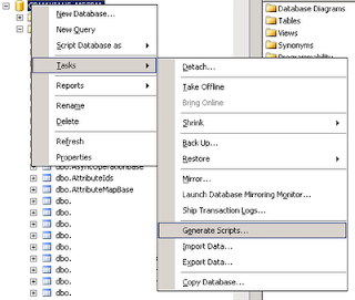

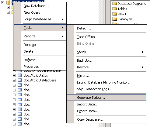

Right click on the database of the CRM organization, Tasks, Generate Scripts.

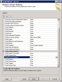

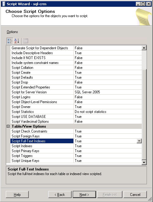

In the options for generating scripts, make sure you turn on all options for tables and views as to the screenshot below.

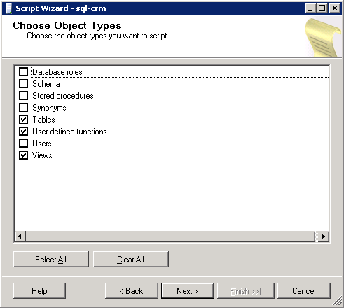

Then select the items that will recreate. We need tables, views and user defined functions.
Follow the wizard to generate scripts for the complete script to recreate the elements that we remove. When selecting items, you have therefore chosen only those items that were listed in the dependencies of AsyncOperationBase table.
