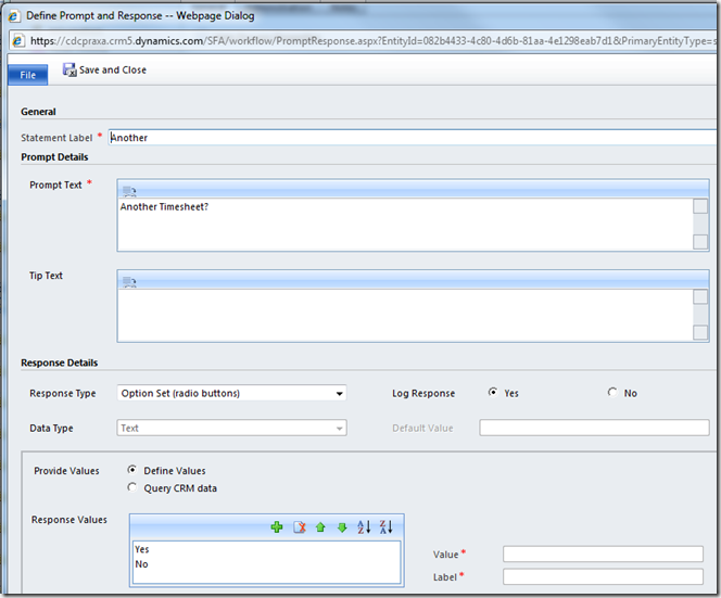

Finally, we have a question as to whether there is another timesheet to enter.

Respawning
Our final step is a conditional which looks at the value given for the ‘Another Timesheet?’ question. If the answer was ‘Yes’, the dialog is called again so a new timesheet can be entered. If the response was ‘No’, the dialog simply ends. One thing that tripped me up here is that the default is to compare against the response Value and not the response Label. Therefore you need to be careful you are comparing ‘Yes’ to ‘Yes’/’No’ and not to ‘1’/‘0’.
