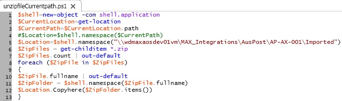

Following code snippet, is the powershell script which I wrote to unzip the files.

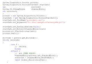

And, here is the X++ code which calls the script
