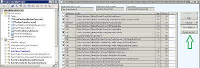

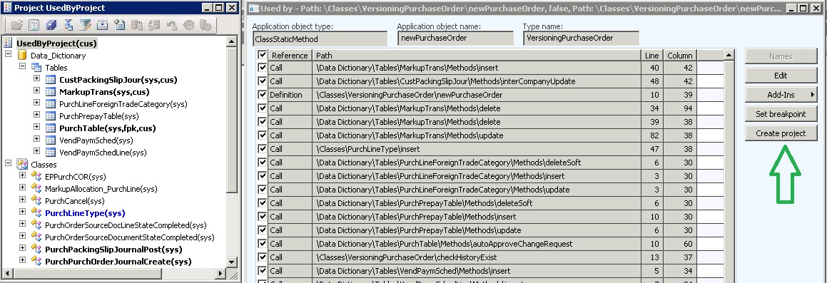

Sometimes one needs to investigate where some field or method is used in the AOT. There may be a long list of AOT paths in the "Used by" form, and having a project with all those application elements may be a good starting point.
Add a button to xRefReferencesUsedByTypedTree form, set its Text property to "Create project" and MultiSelect to Yes:

Now, if you select one or more records in the "used by" grid and press the button, a new project will be created:
