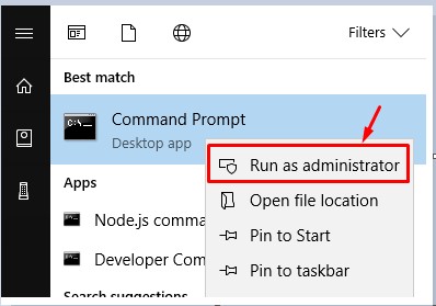

1. Open the Command prompt (Run as administrator).

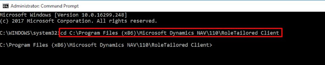

2. Navigate to Path for finsql.exe using the cd command.
** C:\Program Files (x86)\Microsoft Dynamics NAV\110\RoleTailored Client

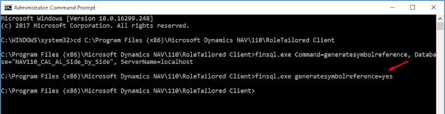

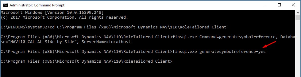

finsql.exe Command=generatesymbolreference, Database="NAV110_CAL_AL_Side_by_Side", ServerName=localhost
4. To Continuously generate symbols each time you compile objects in C/SIDE, run below command.
finsql.exe generatesymbolreference=yes

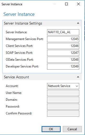

5. Create a new service mapped to the new database created for this exercise.
6. Update NAV Server settings to update generate symbol mapped to the database.
A new setting added in NAV Service tier in Development tab "Enable Symbol Loading at Server Startup." This setting must be enabled to allow any symbol generation.

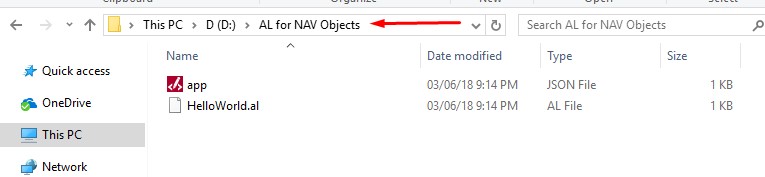

Specify a Path in the Go! the command to create a folder to map.
** You will see Go Windows in the top center of Visual studio code.
Check Folder in explorer.

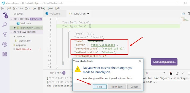

The system will load the default settings as shown below, which specifically set authentication to UserPassword and Server Name as "Your Own Server".
As we are using authentication as Windows.
Update parameters like Server Name, service Name, authentication.

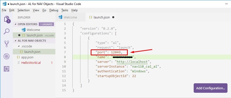

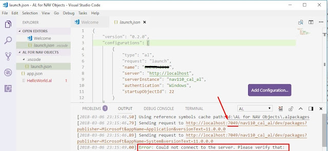

10. If you are using the custom port in development tab, then 7049 you might end up an error message.
11. So let's update the port no in the launch.json and try to download symbol again.
Add Port Number in the launch.json file.

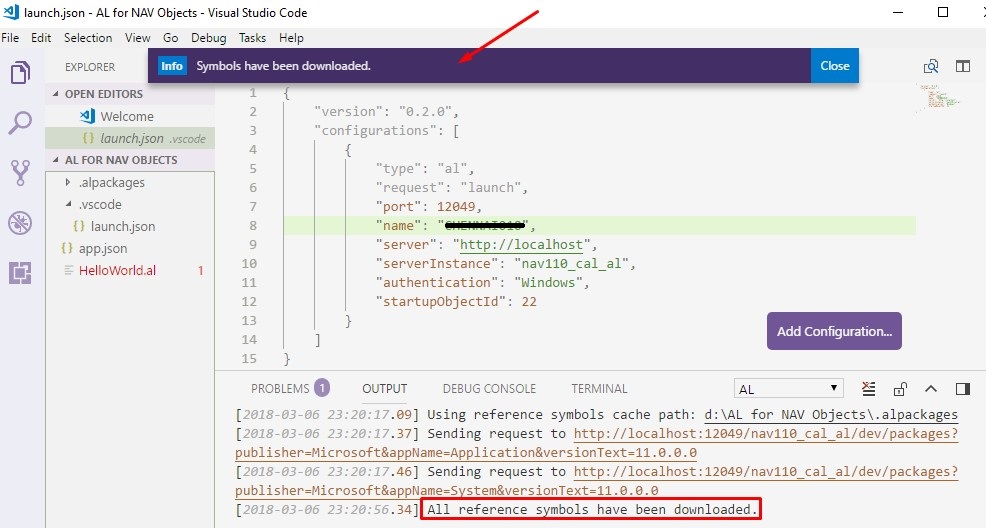

And Load the symbol again.
Hope you are able to execute steps above and able to download symbols in AL.
