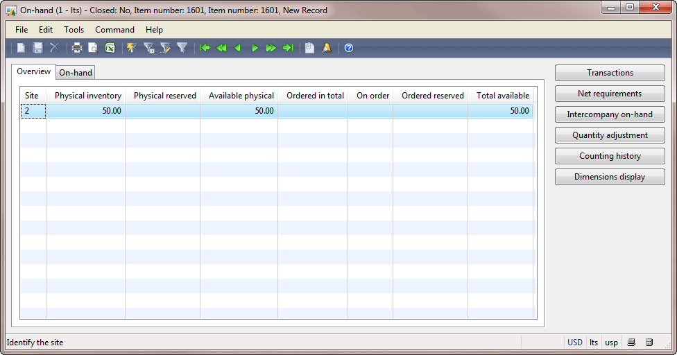

The counting journal has been posted. Let’s check the on-hand inventory for the 1601 item:
  1. Go to Inventory management > Common Forms > Item details. The Item form opens.
  2. Find and select the 1601 item and then click the On-hand button. The On-hand form opens.
    On-hand form
    Note: to view the warehouse, location, and pallet dimensions, click the Dimension display button and then select the corresponding check boxes.

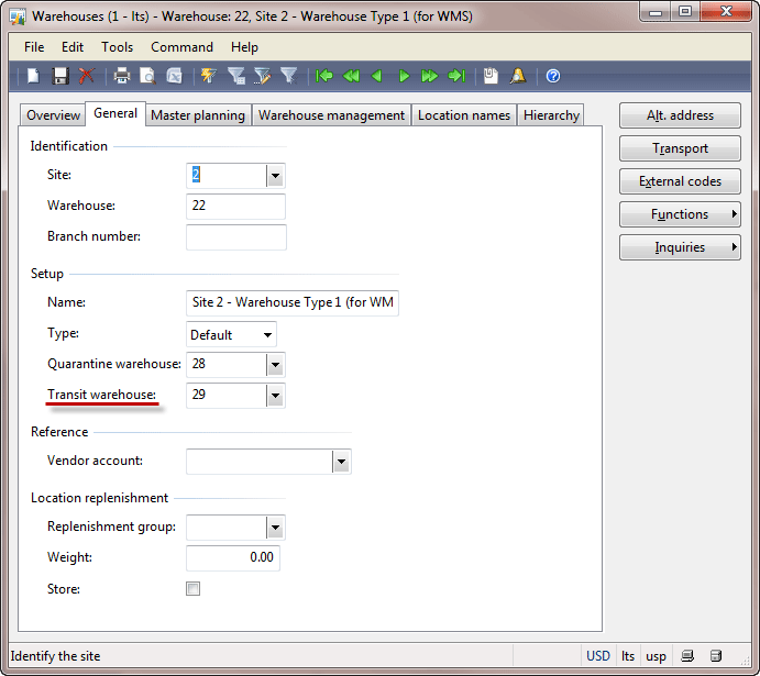

Where is the item on-hand recorded when it is half way from the warehouse 22 to the warehouse 23? These warehouses don’t have the on-hand for the transported items.
In Microsoft Dynamics AX, the transit warehouse is available for these purposes. When items are half way from one warehouse to another one, they are recorded to the transit warehouse.
In our case, the warehouse 22 must have the transit warehouse. Let’s check:
  1. Go to Inventory management > Setup > Inventory breakdown > Warehouses. The Warehouses form opens.
  2. Find the warehouse 22 and then go to the General tab.Warehouses form
    We can see that the warehouse 22 uses the  warehouse 29 as transit warehouse.

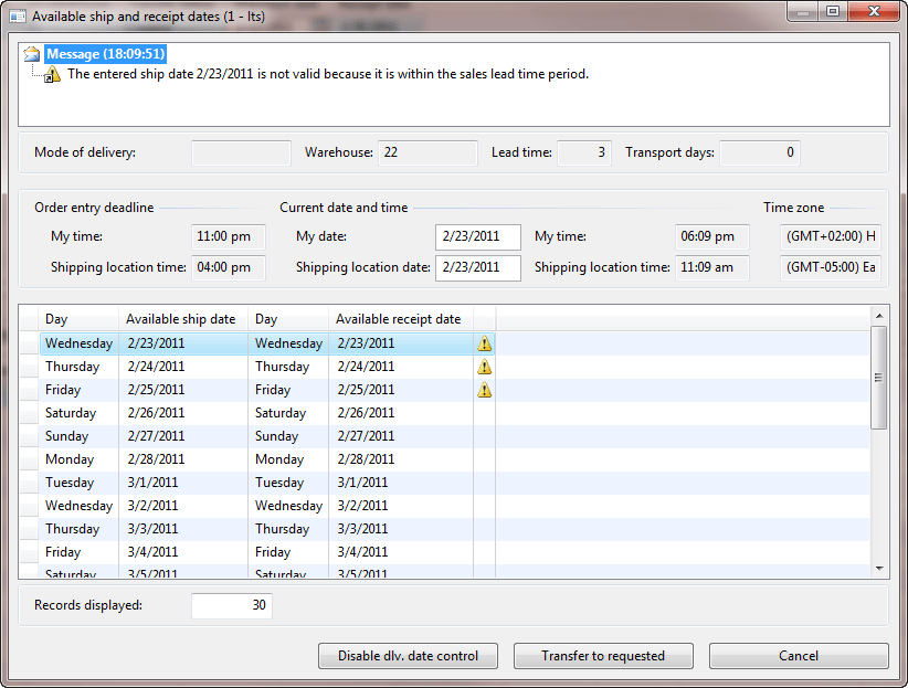

    • Shipment date = today. The Available ship and receipt dates form opens.Available ship and receipt dates form
      This is because the transfer order, like a sales order uses the Delivery date control functionality. To get more information about it, read the Create Sales order article. In this training lesson, we will not use the Delivery date control functionality. Click the Disable dlv. date control button in the Available ship and receipt dates form.

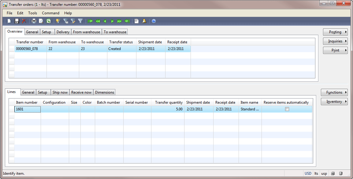

  4. Create a transfer order line with the following values:
    • Item number = 1601
    • Transfer quantity = 5
  5. The Transfer orders form will have the following view:Transfer orders form

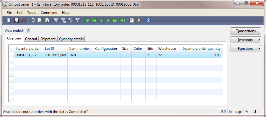

The Inventory Manager creates the output orders:
  1. In the lines area of the Transfer order form, click Inventory > Output orders. The Create inventory order form with the item quantity opens. Click OK.
  2. The Output order form with the created output order opens.Output order form

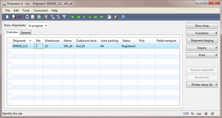

The Inventory Manager creates a shipment:
  1. Go to Inventory management > Common Forms > Shipments. The Shipment form opens.
  2. Create a new line. The Create shipment wizard appears.
  3. Click Next on the Welcome page.
  4. Select the 100_all shipment template and then click Next on the Identification page.
  5. Click Next on the Configuration page.
  6. Make sure that the inventory order is available on the Inventory order page. Click Next.
  7. Click Finish on the Ready page.
  8. The shipment is created:

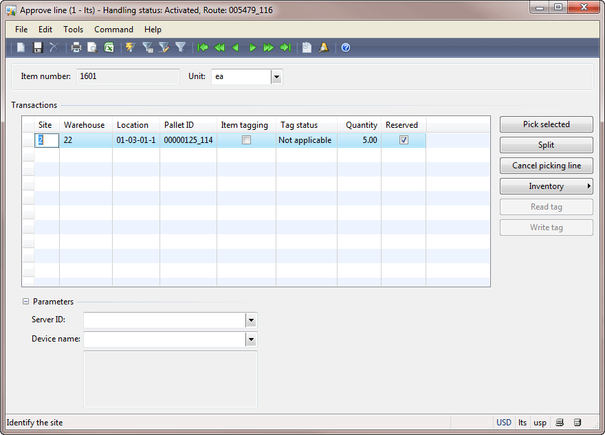

  5. Click the Approve details button. The Approve line form opens.
    Approve line form

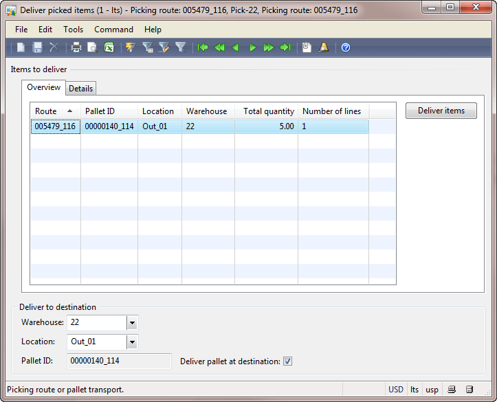

  6. Click the Pick selected button. Since all picking route quantity is approved, the Deliver picked items form opens.Deliver picked items form
  7. Click the Deliver items button.
The items are picked and transported to the outbound location.

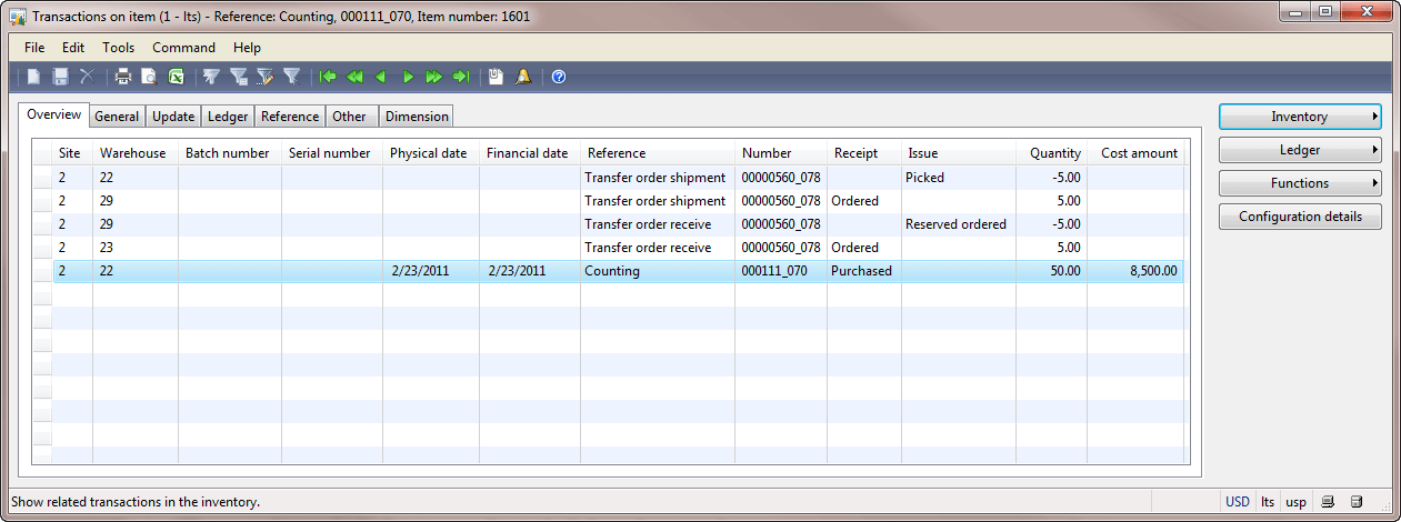

Let’s check the inventory transactions:
  2. Find the 1601 item and then click the Transactions button. The Transactions on item form opens.Transactions on item form. Transfer order items have been picked
Note that the Item form displays all inventory transactions for this item, among them we can see the inventory transactions generated from the counting journal. Don’t take this transaction into account.
We can see the following changes: 5 items are picked from the warehouse 22. The other transactions remain unchanged.
