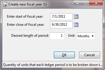

The “Period 2/11/2012 is not open” error message appears. It is because Microsoft Dynamics AX is trying to generate transactions but cannot find an open fiscal period for the current date. We must set up periods for the current year:
  1. Go to General ledgers > Setup > Periods > Periods. The Periods form opens.
  2. Click the Create fiscal year button. The Create new fiscal year form opens. Fill in 1 in the Desired length of period field and Month in the Unit field. Click OK.
The Periods form will look as follows:
Periods form

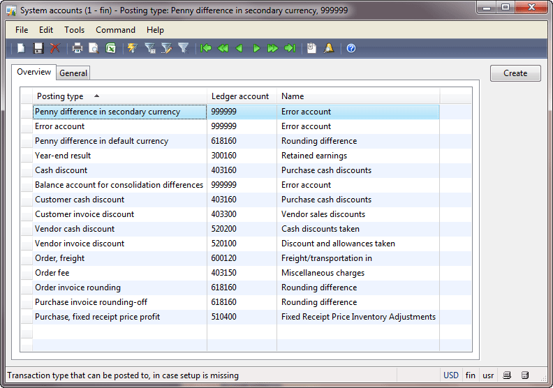

Besides the customer, vendor, and inventory posting profiles, Microsoft Dynamics AX has the setup for the system accounts and sales taxes:
  • System accounts setup is available under General ledger > Setup > Posting > System accounts.
    System accounts form

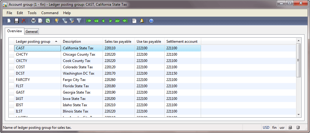

  • Accounts setup for sales tax posting is available under General ledger > Setup > Sales tax > Ledger posting groups.
    Ledger posting groups form

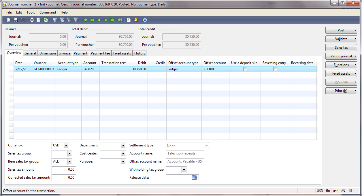

  4. The Accountant writes the following transactions to the general journal:
    140820 (Inventory)211100 (Accounts payable)DebitCreditDebitCredit$30 750$30 750

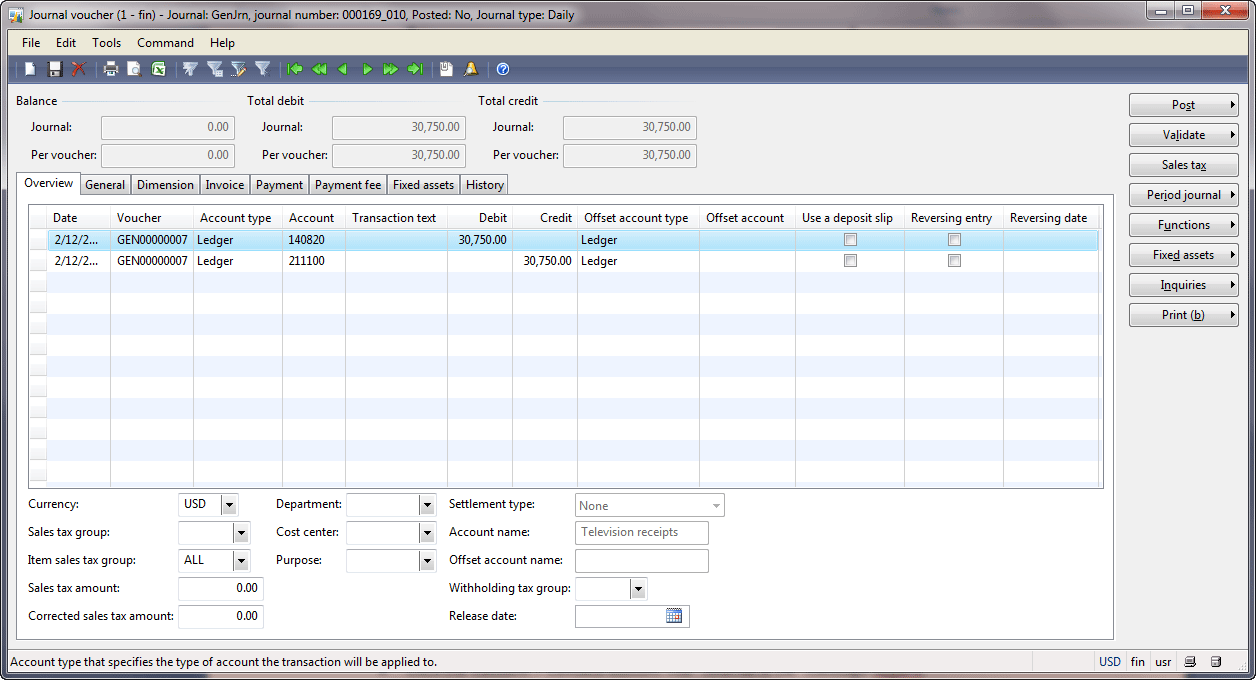

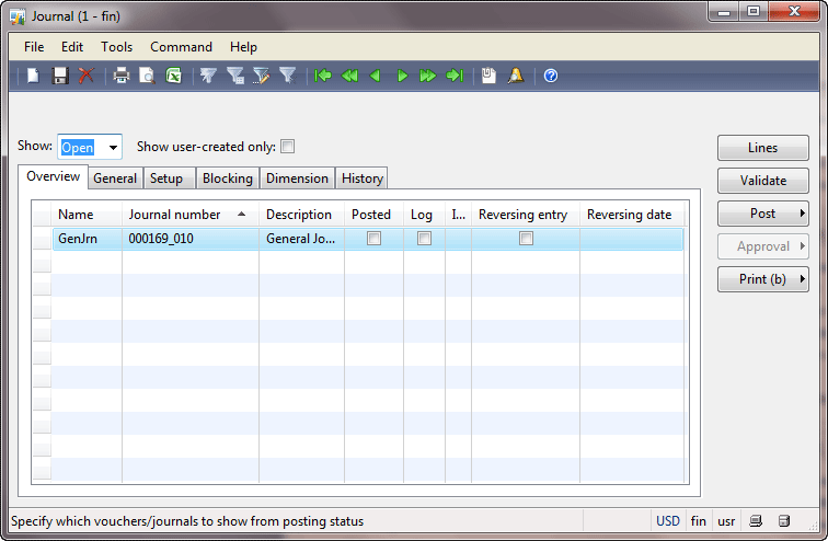

To create a new journal, take the following steps:
  1. Go to General ledger > Journals > General journal. The Journal form opens. Create a new journal by clicking Ctrl +N.
  2. Select “GenJrn” in the Name field.
    Journal form
  3. Click the Lines button. The Journal voucher form opens.
  4. Create a new line. Select the 140820 (Television receipts) account in the Accountfield. The “Ledger account 140820 is locked” message appears. Each account has the setup that enables or disables posting with the help of a general journal. Enable journal posting for both accounts:
    • Go to General ledger > Common Forms > Chart of Account Details > Find the 140820 account > Clear the Locked in journal check box. Perform the same steps for the 211100 account.
  5. Return to the Journal voucher form. Select 140820 in the Account field.
  6. Fill in $30 750 in the Debit field. Save the line.
  7. Crete a new line. Select 211100 in the Account field.
  8. Fill in $30 750 in the Creditfield. Save the line.
  9. Note that for each operation the Debit part should be equal to the Credit part.
  10. Click the Validate > Validate button. The “Journal is Ok” message appears.
  11. It is also possible to record the same transactions in one line with the help of the offset account. The amount will be recorded to the offset account in the differ part. For example, if the amount is recorded to the credit part for the account, then for the offset account, the amount will be recorded to the debit part. In other words, we can write the same transactions in the following way:Journal voucher form
    The journal is also valid.
  2. Crete a new line. Select “GenJrn” in the Name field.
  4. In the Account type field, select “Inventory”. But, there is no Inventory type.
  5. Fill in $30 750 in the Debit field.
  6. In the Offset account type field, select “Vendor”. In the Account field, select 1002.
If we check the voucher (click the Validate > Validate button), the “Account number must be specified” message appears. So, it is impossible to record the Inventory transactions with the help of the general journal. What about the Vendor transaction? If we select Vendor in the Account type field and 1002 in the Account field, move the amount from the Debit to Credit field, remove the offset account and validate the journal. The “The transactions on voucher GEN00000008 do not balance” message appears. The voucher should be balanced, i.e. Debit part = Credit part. Since we can’t select the inventory account, we can’t post the vendor transaction.

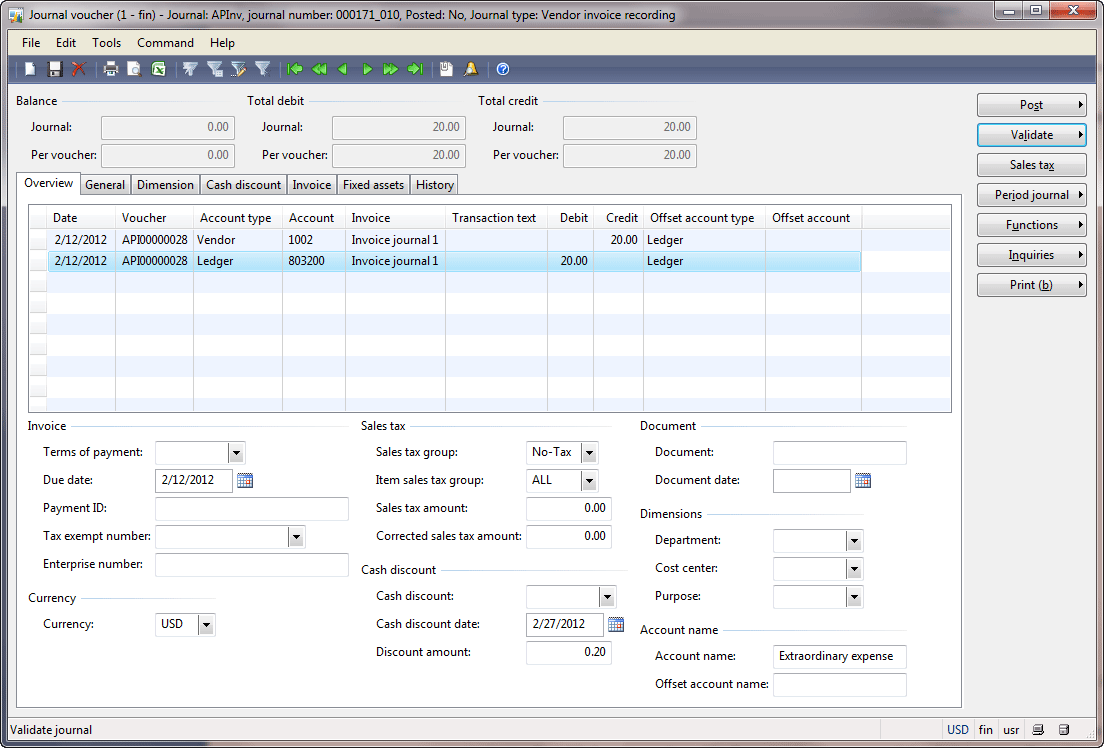

  1. Open the Journal form by clicking Accounts payable > Journals > Invoices > Invoice journal. The Journal form opens.
  2. Create a new line. Select “APInv” in the Name field.
  4. In the Account field, select the 1002 vendor and fill in $20 in the Credit field.
  5. Fill in the Invoice number that is printed on the document. For example, fill in the “Invoice journal 1” in the Invoice field.
  6. The Accountant decides to use the 803200 (Extraordinary expense) account for the Sales Expense. Fill in 803200 in the Offset account field.
Pay attention to the following information:
  • We have used different account types in one transaction (the Account type and Offset account type fields).
  • The Terms of payment field defines the terms of payment, i.e. when the company should pay to the vendor. In our case, the term of payment is N030 (during 30 days). Microsoft Dynamics AX automatically defines the Due date.
  • The Cash discount field defines the cash discount. In our case, the cash discount is 2%D10 (2% discount for 10 days). If the company pays during the first 10 days, it receives the 2% discount. In the next training lesson, we will pay this Invoice and check whether the cash discount is applied.
Since the transaction is balanced, i.e. Debit part = Credit part, we can validate and post the journal. Note that this transaction can be written in the following way.
  1. In the Journal voucher form, click the Validate > Validate button. The “Journal is Ok” message appears.
  2. Click the Post > Post button. The “Number of vouchers posted to the journal: 1” message appears. It means that the journal is posted.

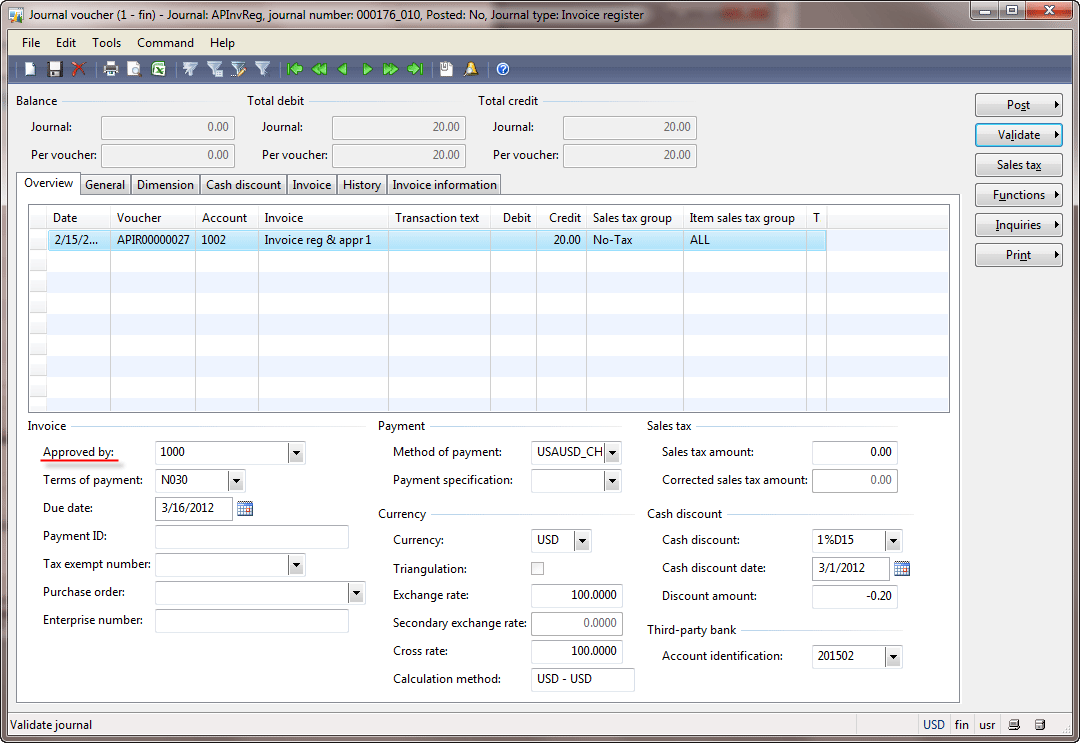

  4. It is similar to the previous form. In the Account field, select the 1002 vendor.
  5. Fill in the invoice number. For example “Invoice reg & appr 1”.
  6. Fill in 20 in the Credit field.
  7. There is no offset account. Click the Validate > Validate button. The “Employee to approve the line is not specified” message appears. Fill in the Approved byfield.
  8. Click the Validate > Validate button again. The journal is valid now.
  9. Click the Post > Post button. The “Voucher is posted and transferred to the pool” message appears.

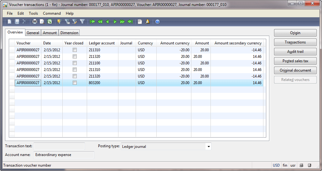

Check what general ledger transaction was created. In the Journal voucher form, click the Inquiries > Voucher button. The Voucher transactions form opens.
The following accounts were used: 211320 was Debited and 211310 was Credited. 211310 is the “Invoice pending approval” account. This account belongs to Accounts payable. 211320 is the “Offset Invoice pending approval” account. This account belongs to the Accounts payable accounts. This is the trick when two accounts from one category are used. It helps post the intermediate values. From the accounting equation point of view nothing is changed, because the transaction has the following view:
Accounts payableAccounts payableDebitCreditDebitCredit$20$20Let’s check the other transactions from the other ledgers. In the Voucher transactions form, click the Origin button. The Transaction origin form opens.

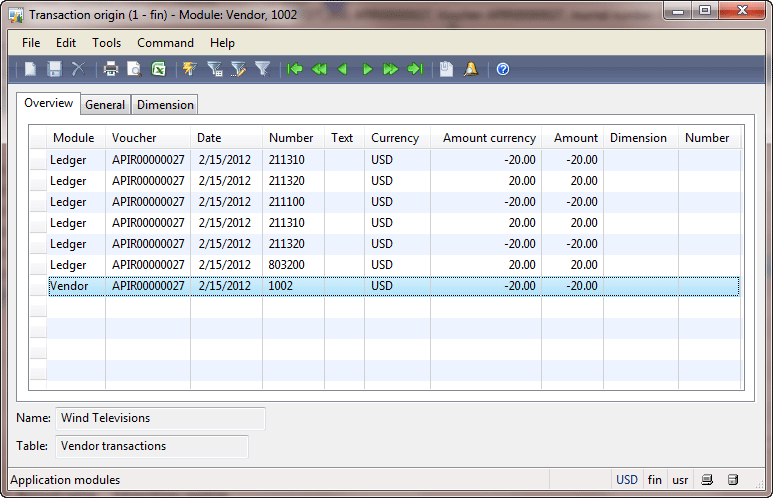

We can see that the Vendor transaction was created.

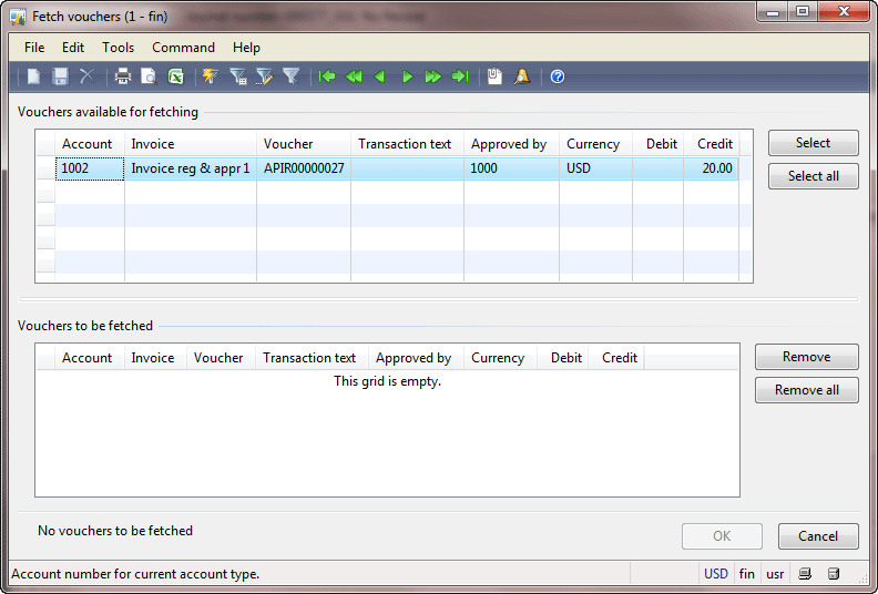

  4. Click the Fetch vouchers button. The Fetch vouchersform opens. The form contains the voucher that was posted in the Invoice registration journal.
    Fetch vouchers form
  5. Click the Select button and then click OK.

  10. Click the Originbutton to see all transactions for all ledgers.
As a result, one vendor transaction was generated, i.e. the vendor balance was changed. Balances of the 211100 and 803200 accounts are changed. Balances of the 211320 and 211310 accounts remain unchanged. The same result was when the Invoice was posted in one step with the help of the Invoice journal.
Only one question is left. Why were the 211310 (as Invoice pending approval), 211310 (as Invoice pending approval offset), and 211100 (as Accounts payable) accounts used?
All these accounts are set up in the vendor posting profile under Accounts payable > Setup > Posting profiles. We already define that “GEN” is used as a default. Go to the Setup tab:
Vendor posting profiles
For all vendors (except “90” – the intercompany vendors), the 211100 account is used as Accounts payable (or the summary), the 211310 account – as Invoice pending approval, and 211320 – as Offset Invoice pending approval.
