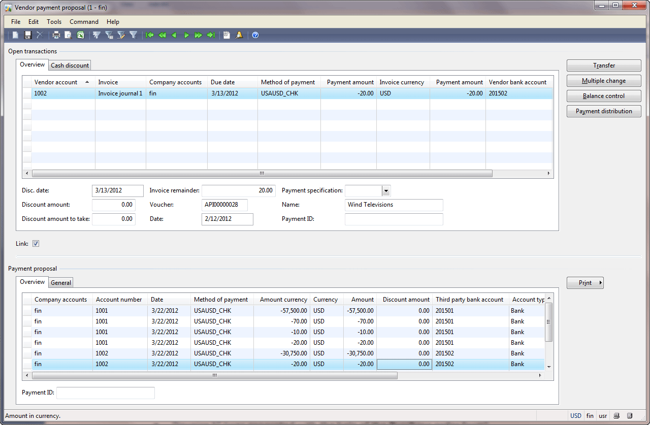

  4. Microsoft Dynamics AX allows automatically creating payments on basis of unpaid invoices. Click the Payment proposal > Create payment proposal button in the Journal voucher form. The Vendor payment proposal form opens. Select “Due date & cash discount” in the Proposal type field. Click OK.
  5. The Vendor payment proposal form opens. Vendor payment proposal form
    The Payment proposal pane contains the payments that are proposed to be paid by the company. The Open transactions pane contains the invoice for which the payment was proposed. If we select another payment in the Payment proposal pane, the information in the Open transactions pane changes. To view all invoices for which payments were proposed clear the Link check box.We can see that there are both invoices that were posted in the previous training lessons and a number of other ones. Select the “222”, “111”, and “485211188” invoices in the Open transactions pane and delete them from the grid (Alt+F9). The Open transactions pane will have only the following invoices:
    • “Invoice 1” (was generated with the help of the Purchase order form)
    • “Invoice journal 1” (was generated with the help of the Invoice journal)
    • “Invoice reg & appr 1” (was generated with the help of the Invoice registration and approval journals).

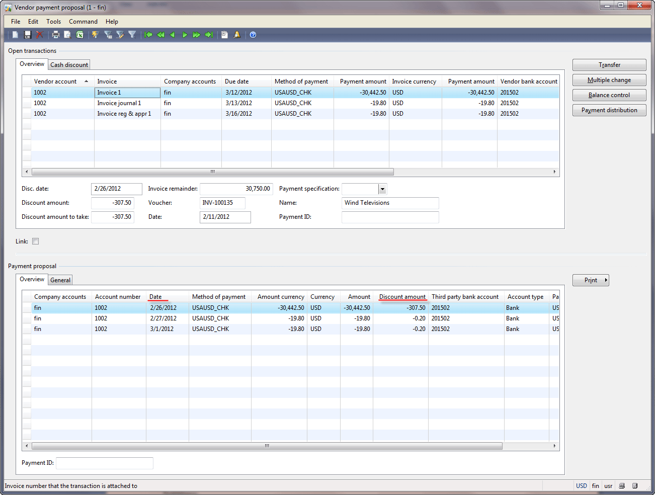

    We can see that Microsoft Dynamics AX proposes to pay these invoices later on the last day when the cash discount is valid.
    Let’s assume that the Company decides to pay today for the “Invoice journal 1”invoice. Delete the invoices “Invoice 1” and “Invoice reg & appr 1” from the Open transactions pane.

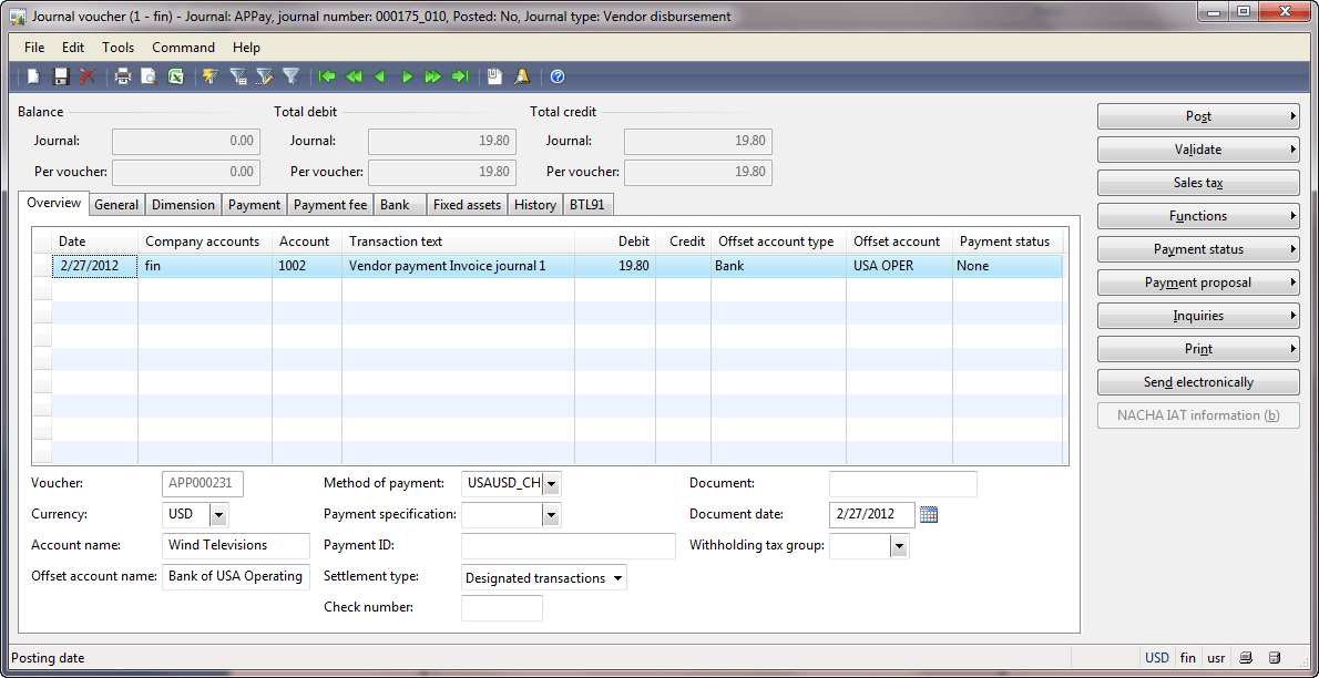

  7. The Journal voucherform will look as follows: Journal voucher form
    We can see that one payment line is created. The “1002” vendor account is debited (for the Liabilities, it means – decreased). The “USA OPER” bank account is credited (for the Assets, it means – decreased). As a result the following transactions will be generated:
    • One vendor transaction for the 1002 vendor
    • One bank transaction for the USA OPER bank account
    • Two general ledger transactions for the controlling accounts.
    The 1002 vendor has the 211100 general ledger controlling account (set up in the vendor posting profile). Note that for the bank account, the controlling account is set up under Bank > Common Forms > Bank Account Details > find the “USA OPER” bank account > Ledger account field. In our demo data, the controlling account for the bank account is 110110 (Bank account – USD). (This account belongs to the CASH&CASH EQUIVALENTS and Asset accounts). The Currency, Method of payments fields are filled in automatically from the invoice. The USA OPER bank account is taken from the method of payment under Accounts payable > Setup > Payment > Methods of payment > find UASUSD_CHK > General tab > Posting field group > Payment account field. We make sure that this field contains the USA OPER bank account. Note that the Transaction text field in the Journal voucher form contains the “Vendor payment Invoice journal 1” text that is also generated automatically on basis of the invoice name.

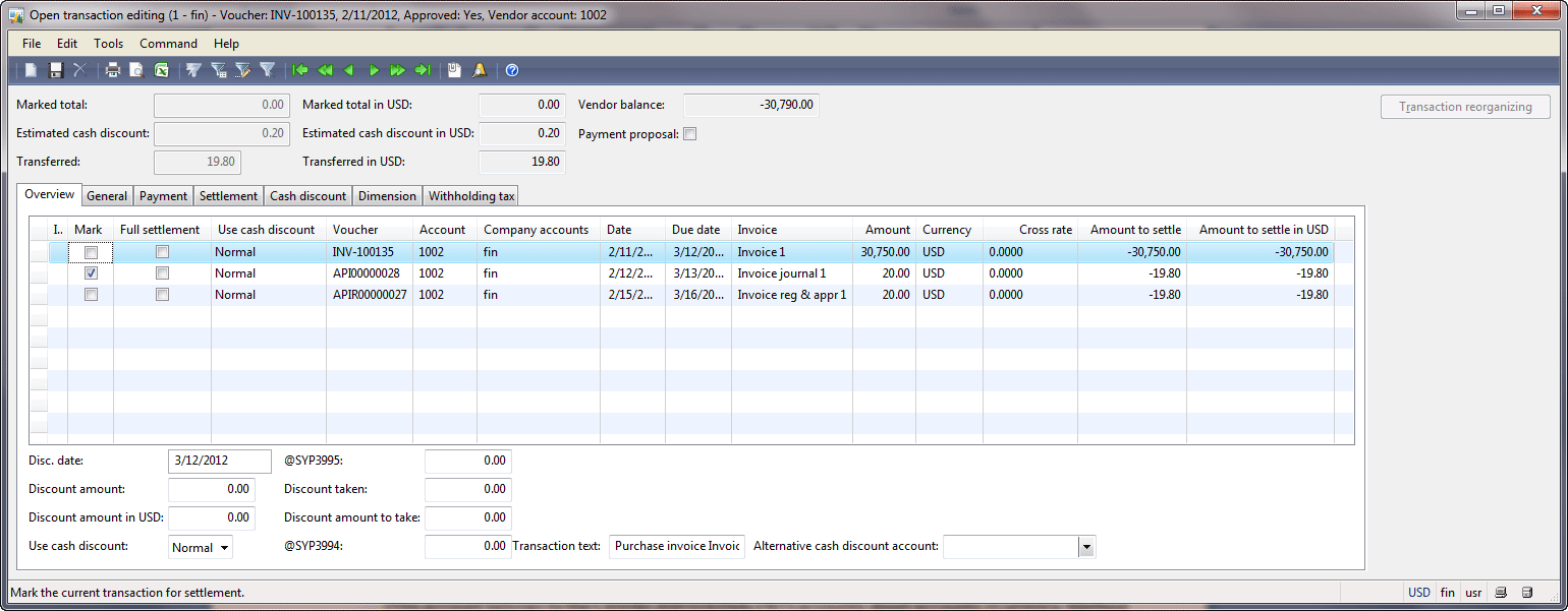

  8. When the payment proposal is used, Microsoft Dynamics AX automatically settles payments and invoices. This is required because the company should know what exactly invoices were paid. To view settlement, click the Function > Settlement button. The Cancel settlement box appears, click NO. The Open transaction editing form appears. This form contains all “open” invoices (i.e. unpaid invoices). We can see that the “Invoice journal 1” invoice is marked, i.e. settled with the payment line. Note that we could manually change the settlement.

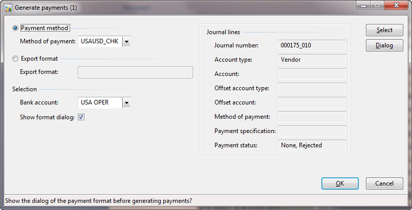

  9. The Payment Manager checks all payment details. Since all information is correct, a payment check can be generated. In the Journal voucher form, click the Functions > Generate payments button. The Generate payments form opens. Select “USAUSD_CHK” in the Method of payment field, “USA OPER” in the Bank account field, and then select the Show format dialog check box. Click OK.

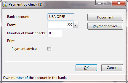

  10. The Payment by checkform opens.
    Payment by check form
  11. Print the check to the screen. By default, checks are printed but we will change this setup to Screen by clicking the Document button. The Printer setup form opens. Select Screen and click OK. In the Payment by check form, click OK.

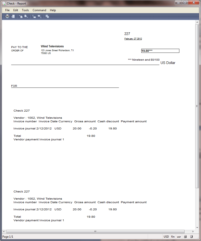

  12. The check will be shown.
    Check report

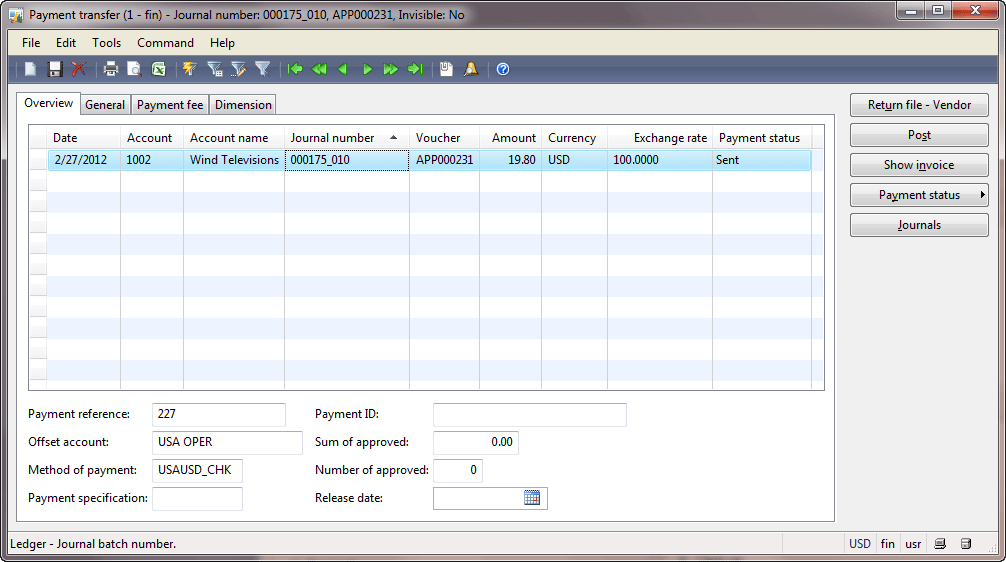

  13. Return to the Journal voucher form. The value of the Payment status field is changed from None to Sent. It means that the payment is sent to the Vendor (checks, money, electronic transfer, etc.) but not yet received by the vendor.
  14. For convenience, all sent payments are displayed in a separate journal under Accounts payable > Journals > Payments > Payment transfer. In this case, the Payment Manager can send all necessary payments during the day and then register the received status at the end of the day. Payment transfer form
    We assume that the Payment Manager calls the vendor to ensure that the check is received. If the electronic payment method is used, the return file is generated when the vendor receives the payment. In this case, the return file is loaded with the help of the Return file-Vendor button, validated, and the status is changed to Received automatically. In our case, we change the payment status from Sent to Received manually. Click the Payment status > Received button. The payment status is changed to Received. Note that this step is optional.
  15. Close the Payment transfer form and return to the Journal voucher form (click F5 to refresh data). Make sure that the payment status is Received. Since the payment is received, the Payment Manager posts the payment. Click the Post > Post button. The voucher is posted successfully.
