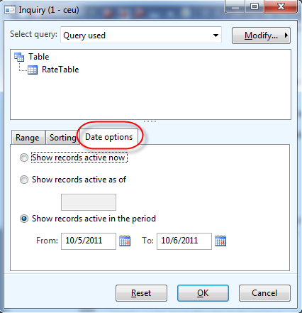

The query dialog that now comes up, will automatically have an extra tab after Range and Sorting, called "Date Options".
Here you can change the date ranges used, or flip to as-of date selection, on top of your usual filters. If you want the one active record, your job should look like this:
static void ValidTimeStateTest(Args _args){ Query query; QueryRun queryRun; RateTable rateTable; date rateDate = systemDateGet(); query = new Query(); query.addDataSource(tableNum(RateTable)).addRange(fieldNum(RateTable, RateID)).value(queryValue('DAXMusings')); query.validTimeStateAsOfDate(rateDate); queryRun = new QueryRun(query); if(queryRun.prompt()) { while(queryRun.next()) { rateTable = queryRun.getNo(1); info(strFmt("%1: %2 - %3", rateTable.RateID, rateTable.ValidFrom, rateTable.ValidTo)); } }}
So notice how the query dialog shows both option (as-of as well as date range) so you can flip between the two, you basically provide a "default" in your query object (just like ranges, sorts etc).
