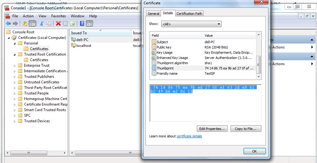

2.Manage Certificate (Permission of SSL Certificate)
Please follow the below steps
  • Open the Microsoft Management Console (mmc.exe)
  • Goto file menu and click on Add/Remove Snap-in (Ctrl-M)
  • Add Certificate (Select Certificate then click on ADD chose Computer account and then click on Next Button and then Finish)
  • Select Certificate and click OK
  • Assign Permission to certificate.
    • Locate the certificate you just created in the PersonalàCertificates folder
    • Select Certificate à Right Click à All Tasks à Manage Private Key
    • Add Permission for the Account which is used to Run Dynamics NAV Services
    • Copy this certificate
    • Paste this certificate into the Trusted Root Certificate
    • Keep the Thumbprint Value for future Reference.

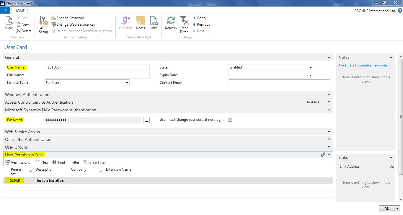

3.Microsoft Dynamic Nav Server must be configured to run with NavUserPassword
  • Create New User
    • create a new user (TestUser).
    • Enter User Name & Password.
    • Set User Permission Sets - SUPER

    • Update Certificate Thumbprint
    • Certificate Thumbprint is your SSL Certificate Thumbprint value
    • Note: - In the text editor, delete all spaces from the thumbprint string.
    • For example, if the thumbprint is ‎74 14 86 75 ea 9b ad 27 0f af 63 2d a8 61 b2 49 b6 e2 0c 11, then change it to 74148675ea9bad270faf632da861b249b6e20c11
